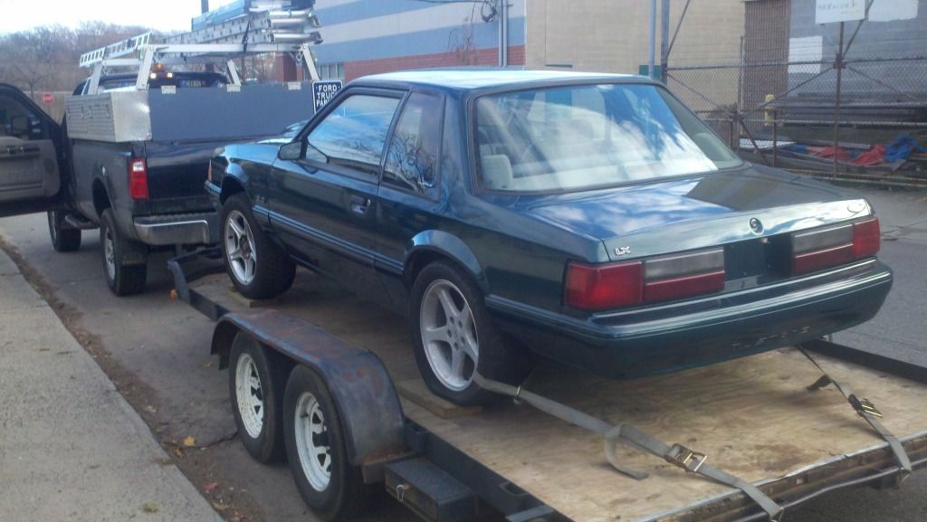

BOUGHT

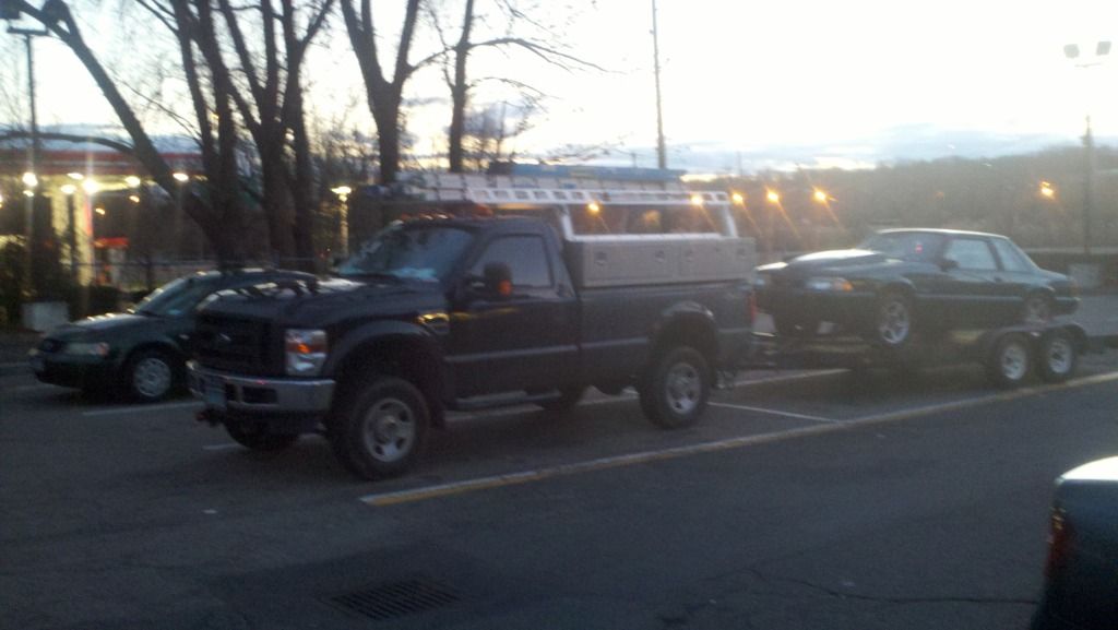

Thanks Joe good to have friends in low.......... with trailers lol, (nojoke)

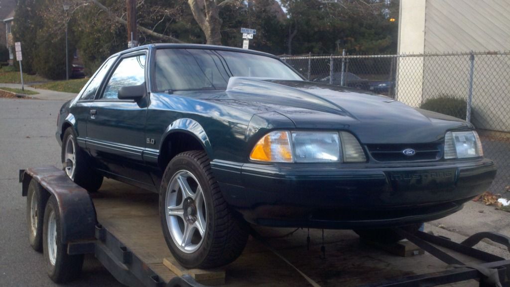

a little info on it, .... It was on Craigslist for a while, we all know I am a cheap $^&* but this thing was so clean and I needed a clean shell ....... and as soon as I was able to sell mine as a Roller, I picked this one up ... here is the ad, on the Corral,
For Sale 1991 Ford Mustang Coupe ** SUPER CLEAN** Roller or Running - Ford Mustang Forums : Corral.net Mustang Forum
The car has very clean gray full interior,no rust, never hit, body straight,
some rear end work,
tubular rear control arms
,battery relocated in trunk,
5 lug conversion,
lakewood drag shocks front and back,
flaming river manual rack,
sub frame connectors,
4 inch Cervini cal hood,
the car was painted few months before i bought it and is a 8.5 out of 10.
The engine bay has also had some unecessary holes filled in and also painted

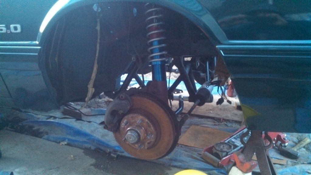

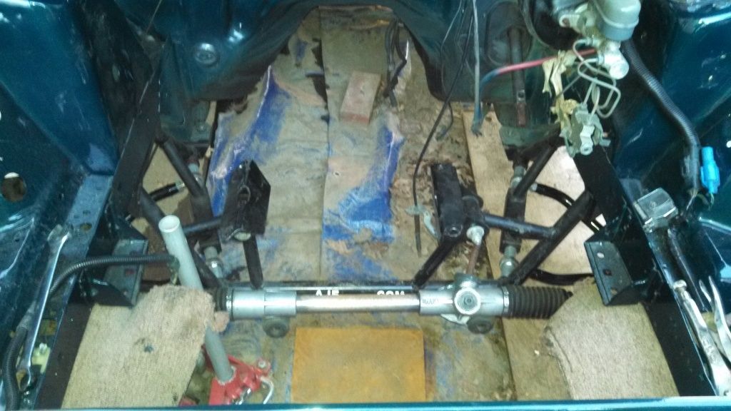

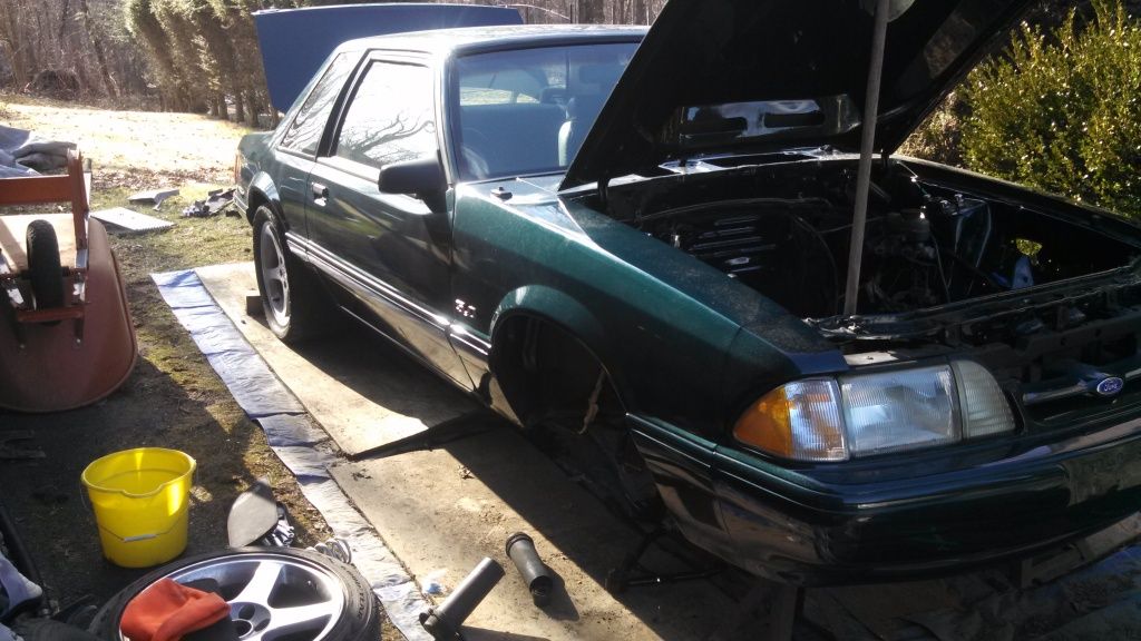

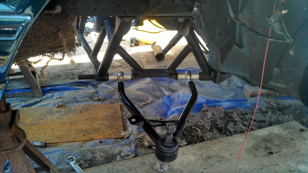

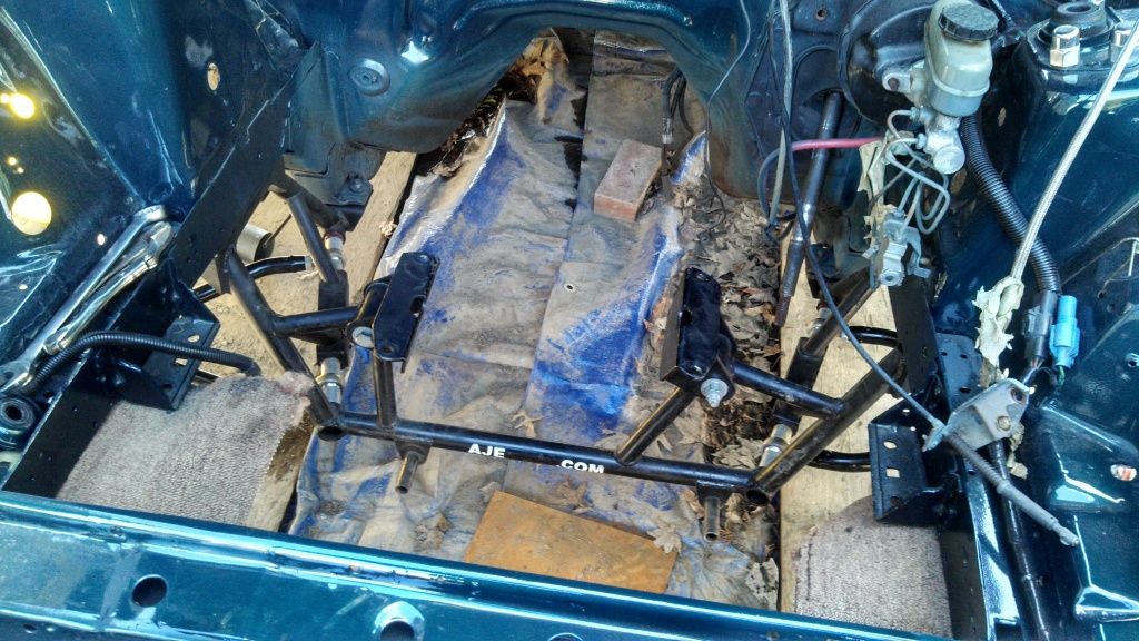

today was actually surprisingly productive, I started the day wanting to swap out the stock K with my AJE Tubular, PA Racing Tubular Control arms and UPR (Eibach) Coilover kit, .... and, wouldn't ya know it..... I actually did.....

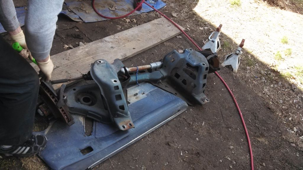

anyone need a stock one?
Tubular AJE K member
what a pain in the ass, for anyone buying the Coilover Conversion kit, keep in mind you will have to grind the Dust Cover flush with the Strut body, I wish I remembered to take a picture of that, but oh well, it is a pain... just so everyone knows
soo........ For everyone who said it would never get done!......... BABY STEPS BITCHES! hahah I would like thank bax, for making me have to play catch up, and my brother for helping me do all of this, I recently also got some Direction from Waldo, MaximumRisk, ... so slowly but surely she is coming together...
