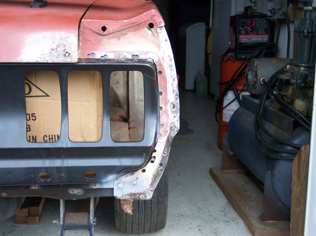

Here is the r/s trunk corner after removing what was left of the quarter panel skin in prep for fitting the new r/s quarter skin.
