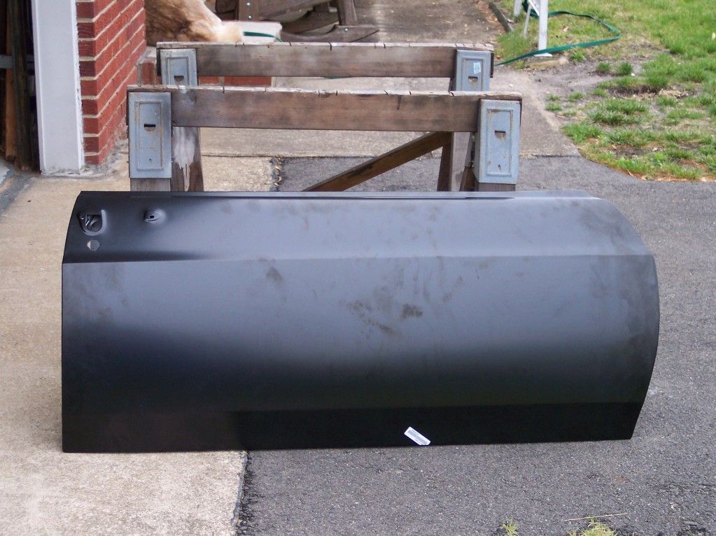

Well it has been a while since I posted any updates, but today I ordered the r/s door skin from CJ's and took advantage of their 20% off sale. I will post pics as soon as I recieve the door skin.

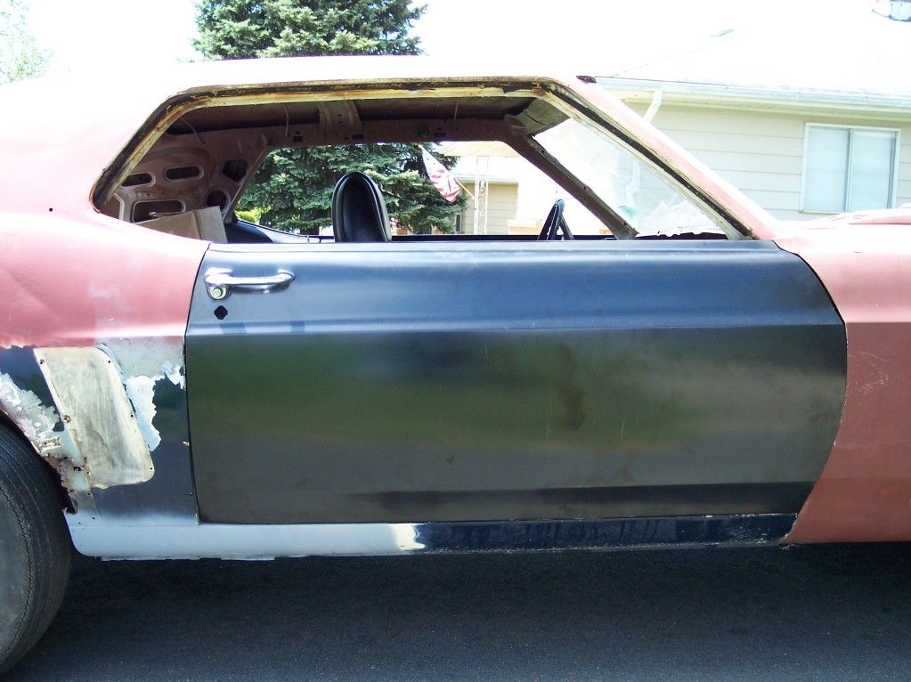

Update on the r/s door, I finally got the new door skin & it was nice weather today so I installed the new door skin & got the upper door hinge rebuilt today. I have to do some work on the lower hinge as the holes are out of round
Thanks Bruce, the door skin I originally ordered was made by Dnyacorn & was o backorder until end of June so I had CJ's cancel that order & send me the one they had in stock. I think it came out great.
I got a chance today on my day off to hang the r/s door with the new door skin. It looks good & lines up well, I just have a little work to do to the l/s lower corner. I LOVE new sheet metal.
