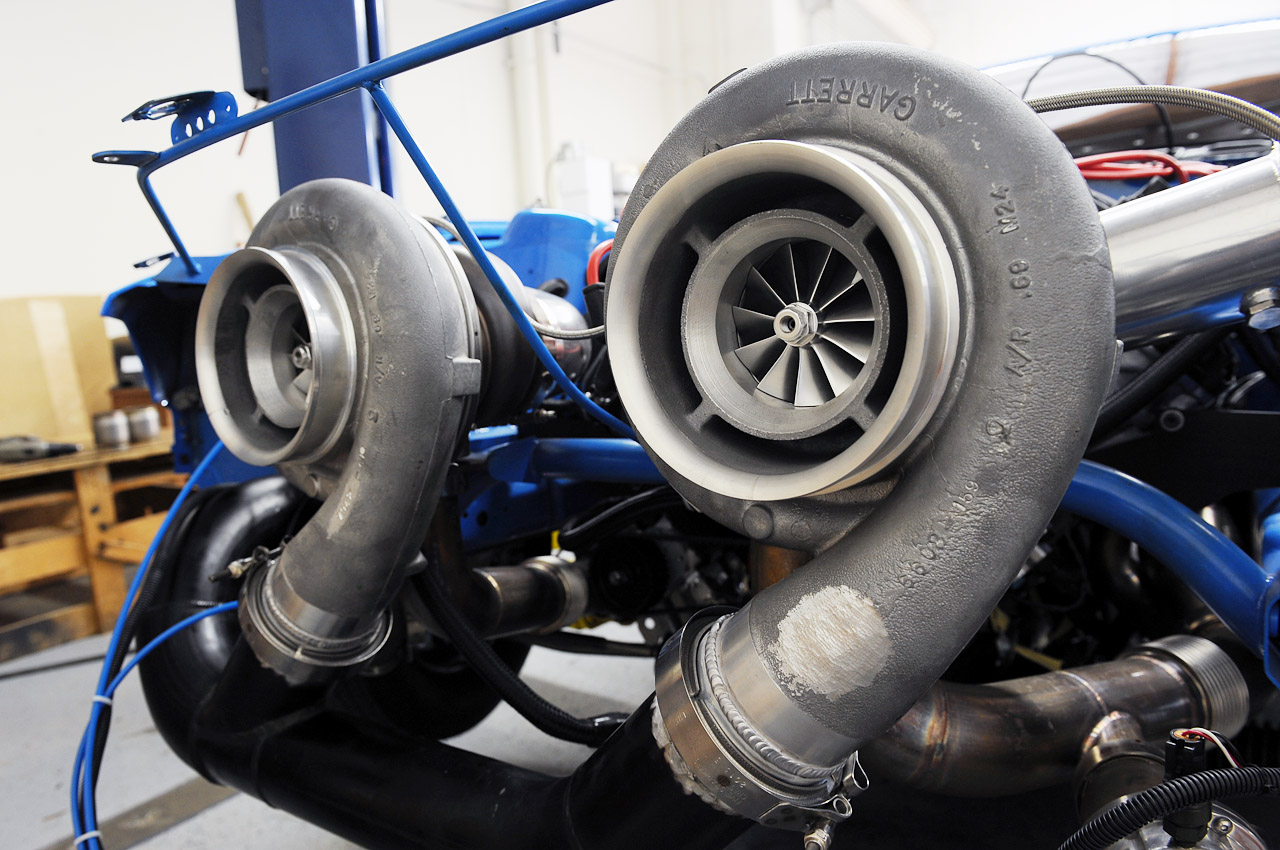

So how does one go about building a 2,000+ horsepower V8? MMR starts with the stock aluminum block and stuffs it with forged Manley M2500 pistons and billet connecting rods, a Cryo-treated and race-prepped Boss 302 crankshaft and custom turbo camshafts. MMR also adds a set of Stage 3R ported Boss 302 heads and their own Roadrunner intake manifold paired with an Accufab 105mm throttle body, all fed by a pair of massive Garrett 80mm GT4508X turbochargers.
