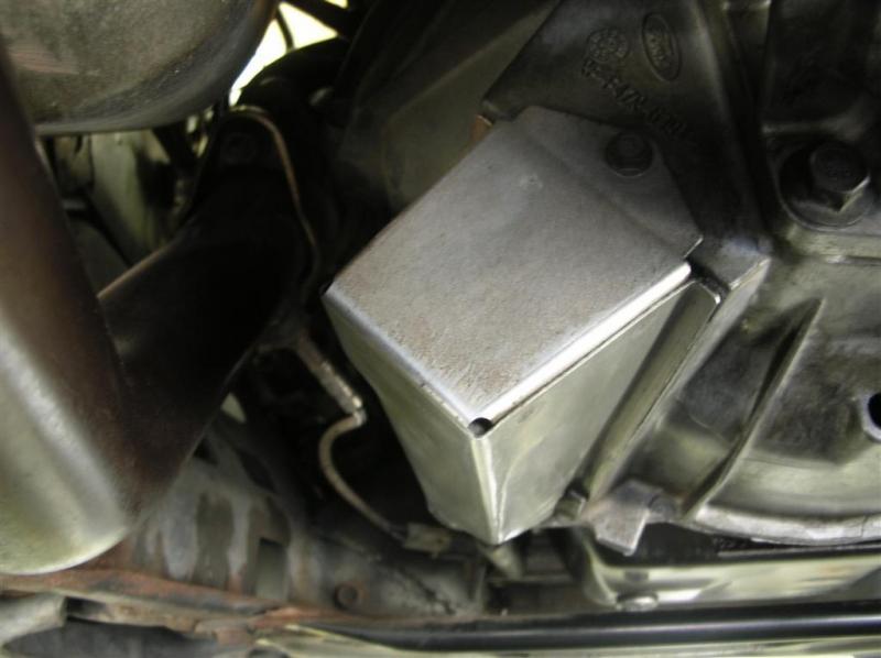

Here's the old driver side sensor:
Here's what it looks like from a bit further back:
