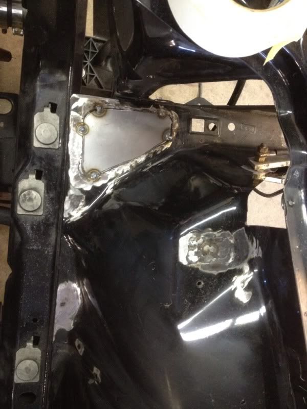

What we decided we were going to do is relocate everything in the engine bay and then SHAVE it completely. The ECU and fuse box are the main concerns and we were hoping to not have to extend too many wires but Its impossible in my case.
- ECU in the Passenger side fender
- Fuse Box behind passenger side glove box.
I held off on doing the ECU and Fuse box and instead moved my direction to the ABS unit.
Line lock was being a PITA! Used one hole already on the ABS unit then created a tab to "reach around".
Used the Stock Mount and modified it to work in the location of choosing.
Very stiff and will bend in a fender bender rather then break.
Take into consideration I bent all those by hand. lol
Once I pulled the motor we stripped everything out of the engine bay prepping it for patches and filling the holes.

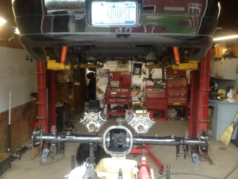

Got the rear end put back together last week.
Checking the back lash getting everything precise.
Welded the Axel tubes and the BMR Relocation Brackets to the the rear.
After getting the Rearend all welded up we put her back up in the car!
