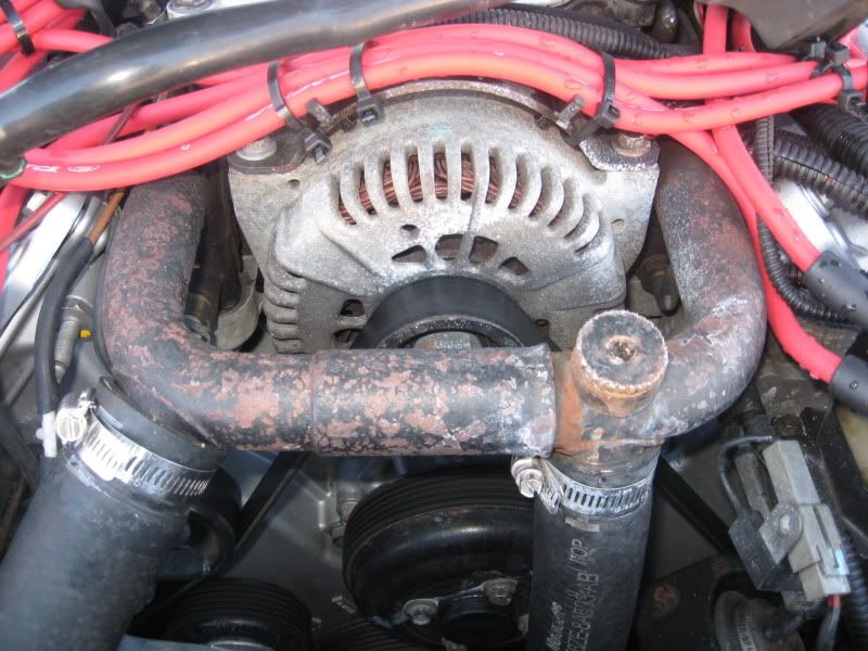

thats what i orig. wanted to do, but looking at it, and the underside of it, its badly rusted and i dont want it to give out on me or something. if i did repaint it though id also need a new cap bc at one point the old one was like seized on there and its stripped now and i have to open it with channel locks, so its all chewed up
edit** i forgot i had the pic posted lol. you can obviously see its chewed up, but that one spot is badly rusted esp. on the underside
