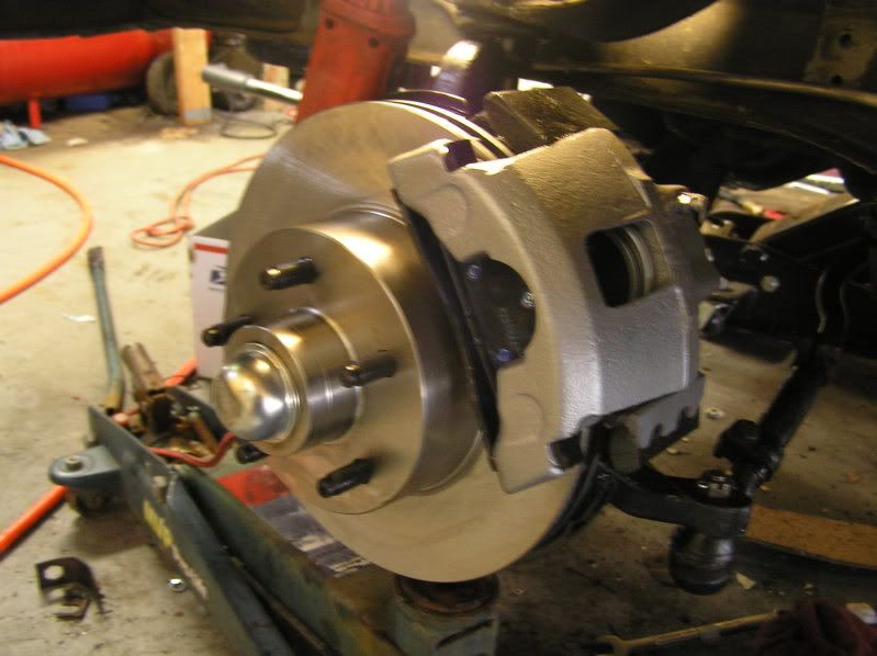

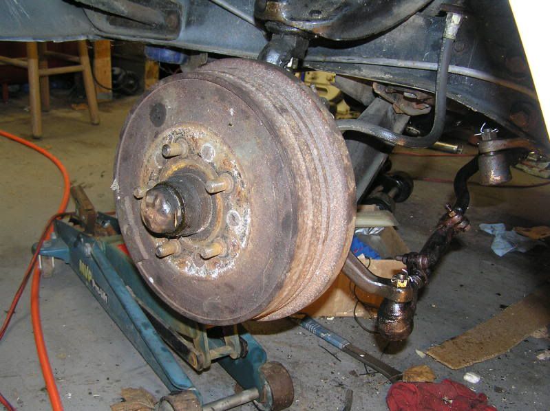

I do have to deal with the brake light switch, I plan to use the orig dist block and a separate proportional valve. This should free up one port on the dist block so I can add the brake light switch, haven't completely figured that one out yet. If you havn't checked out this site yet
http://www.midnightdsigns.com/james/ , it is great for info , I am following most of his info on the brake swap. I have 15inch Rims now so clearance shouldn't be a problem. I may run new brake lines , but mine are fairly new already. The orig parts are definitely for sale and are in really good shape.
If I didn't have the parts already I would probally go with the scarebird set up
www.scarebird.com because you don't have to take everything apart and no effect on bump steer.
