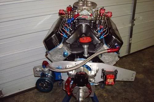

Nope! But I did just aquire the top half of that engine for my X275 build!!
Blue Thunder Canted Valve 3.6's, 2.190/1.65 Titanium valves, Pac springs, complete Jesel shaft rocker system, titanium retainers, full race ported and flow 398 cfm intake / 288 cfm exhaust at .800' lift, Edelbrock cast intake with 2 Induction Solutions flowed direct port foggers. Should make 850 to 900 hp naturally aspirated on the 434ci small block I am building. I will be spraying about 500hp through it.
