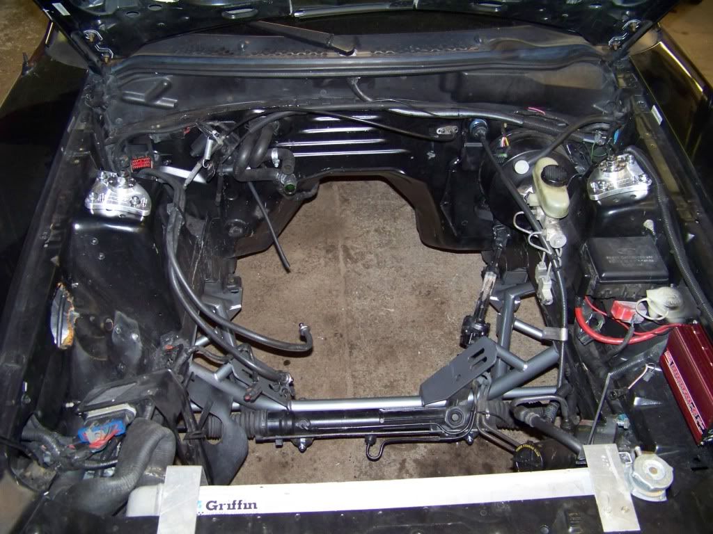

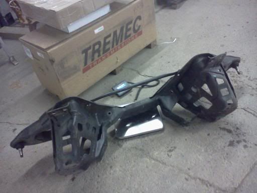

Took out the stock K-member tonight.
Here she is:

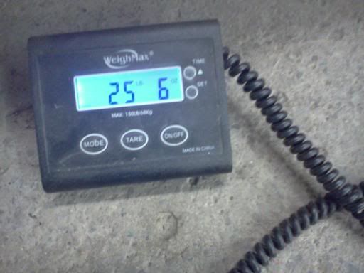

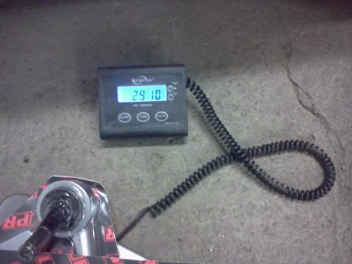

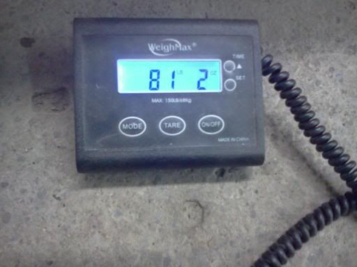

Weight of Stock K-member and A-arms:

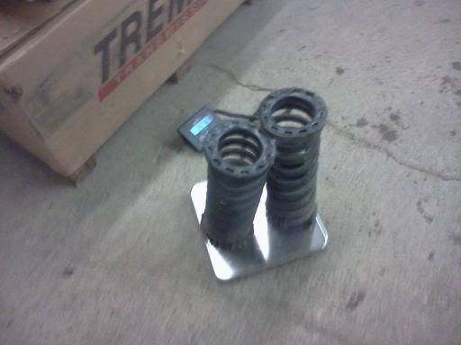

Stock Springs:

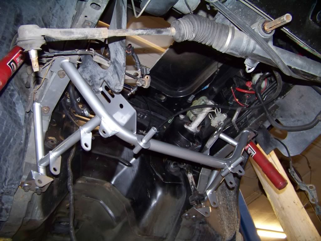

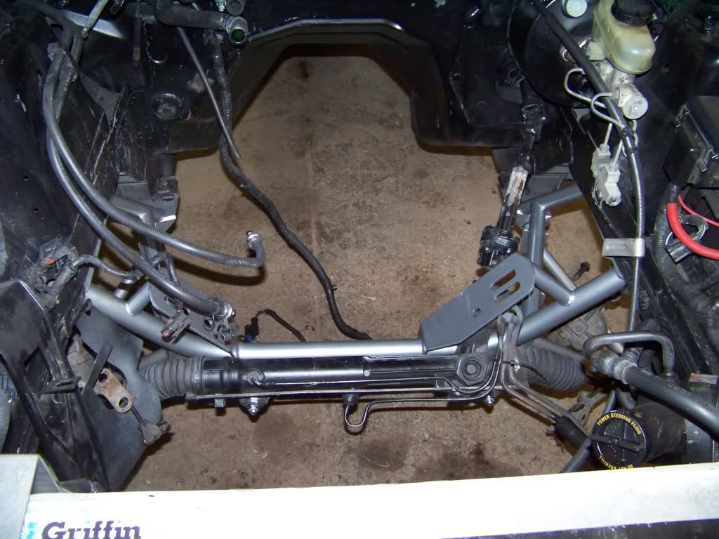

Here is the new Chromoly k-member and arms from UPR:
That's a 51lbs saving on the K-member and arms alone.

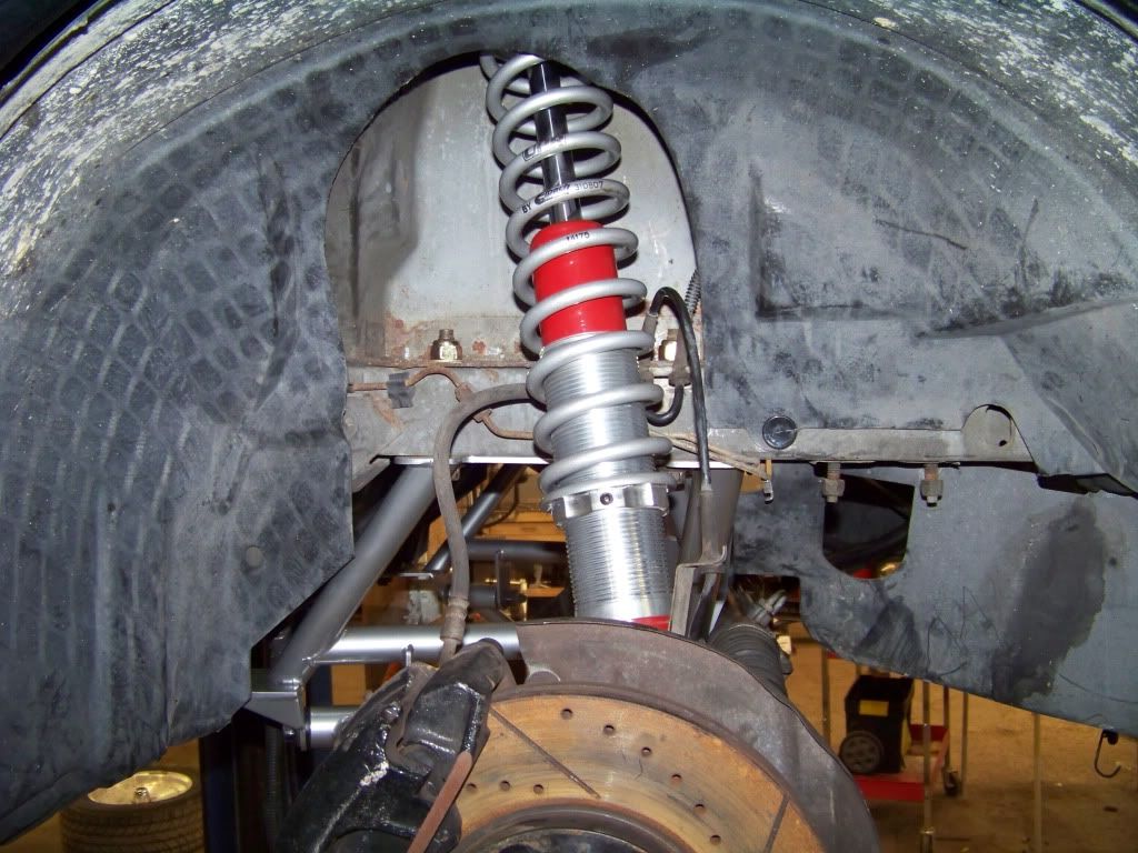

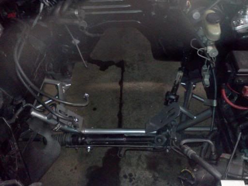

The coil over springs are only 7 lbs each, so they will be 14lbs vs. 25lbs for the stock ones.
That comes to a 62lbs total saving, plus all the clearence I've gained in the engine bay, and the ride height adjustment I'll have.
More pics to come of the new k-member installed.
Thanks again to Doug.
