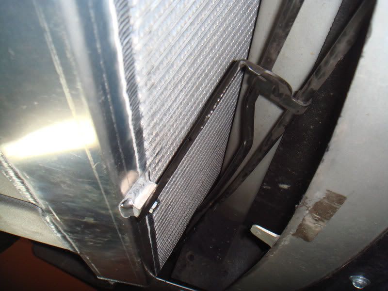

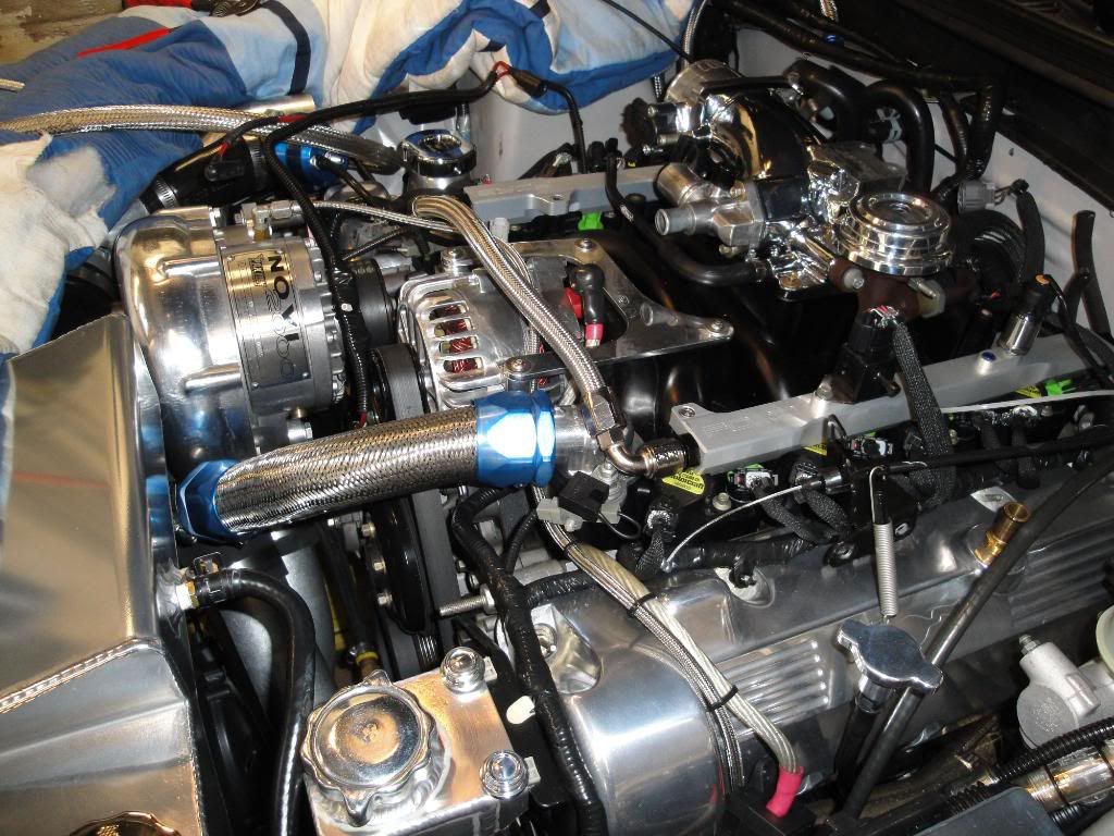

In progress pics of the Paxton A/A intercooler I did in my garage back in Nov 2007:
Blower reclocked with Reichard Racing ultra-grip blower pulley installed.
Powersteering cooler dropped to make way for intercooler.
Tight squeeze for intercooler...but it all fits.
Stock Paxton intake tube w/ 90mm LMAF.
Modular Powerhouse 4" boost pipe marked for trimming.
LMAF mounted in passenger side fenderwell.
Installing intercooler piping.
Setup complete minus Vortech mini-race bypass.
Took it to Steve at Pitbull Performance to get bypass welded in.
The Paxton A/A intercooler was a very tight squeeze, but it all fit w/o hacking into any of the car's sheet metal. The powersteering lines going to the cooler can be extended and re-routed to make more room for the intercooler. At the time, I just wedged it apart with 2x4's to make the room.

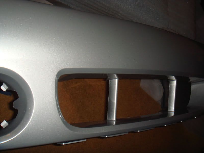

Pics of some cosmetic surgery...installed a 03 Cobra front bumper to make use of the larger front opening for the A/A intercooler. Was purchased pre-painted on Ebay and shipped to my house for $374. The chin spoiler, foglights and bezels were purchased from Late Model Restoration. Saved me a trip to the body shop:
Stock bumper bracket rivets have to be drilled out to reuse the bracket on new bumper.
I didn't have replacement rivets, so I tapped the holes to accept 1/4-20 bolts. Rivets let the bumper sit 100% percent flush...so don't do what I did.
To complete the rest of the body mods, I did make a trip to Federal Autobody in Queens to have them paint and install Cervini's Stalker side skirts, MRT-B rear spoiler, Bullitt side scoop deletes, and black out the center section of the trunk lid:
